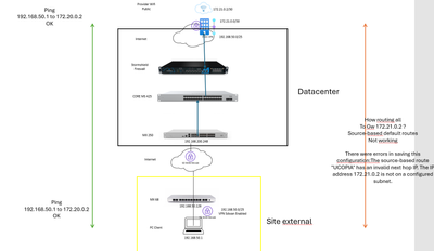

Current Architecture
  • Remote site connected via SD-WAN (AutoVPN) to our central site
    • Remote MX: MX68 (Spoke)
    • Central MX: MX250 (Hub)
  • Remote site LAN subnet: 192.168.50.0/25
  • IPsec tunnel (Datacenter ↔ Public WiFi Provider)
    • Remote provider subnet behind IPsec: 172.21.0.0/30
    • Provider cloud equipment IP: 172.21.0.2
Current Status
  • Traffic from the remote site (192.168.50.0/25) successfully reaches the central site through SD-WAN (AutoVPN).
  • From the central site, traffic properly traverses the IPsec tunnel.
  • We can successfully reach the provider subnet (172.21.0.0/30) from the remote site.
  • End-to-end connectivity between 192.168.50.0/25 and 172.21.0.0/30 is working correctly.

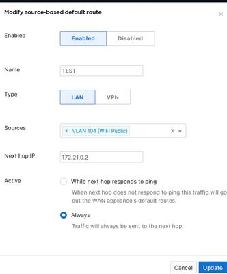

When attempting to configure a source-based default route on the MX, we receive the following error:
"There were errors in saving this configuration:
The source-based route 'UCOPIA' has an invalid next hop IP. The IP address 172.21.0.2 is not on a configured subnet."
It appears that the MX does not accept 172.21.0.2 as a valid next hop because it is not part of a locally configured subnet, even though it is reachable via the IPsec VPN.
