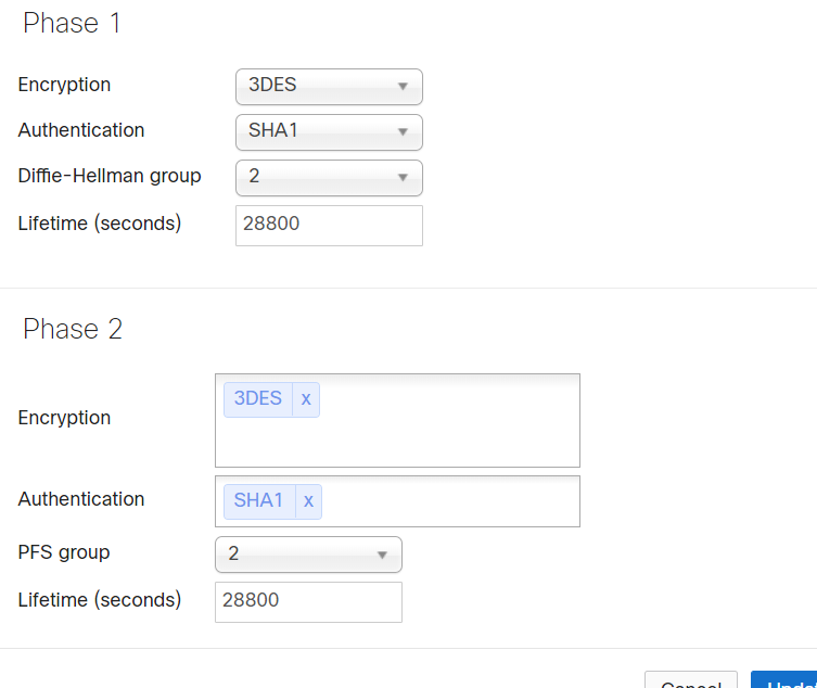

Then on Meraki
Let me know if any more info needed in order to troubleshoot, i have the public address in the router with a preshared key that i have entered on Meraki and that matches.

First thing, on an unrelated matter, Meraki MX's have terrible 3DES throughput.  Additionally this is an old algorithym no one should be using any more.  Change to using AES.
That config looks correct - so that tells me there is some other config that is not correct.  Do all your MX's have a VPN to this 2911?  If not, are you using a tag so that only specific ones are building the connection?
