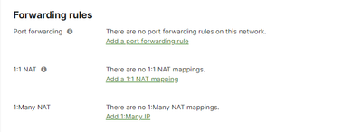

One more thing, do you have any NAT or port forwarding for port 443 configured on the MX?
If this is the case, it will also be a problem, so you must specify another port for Anyconnect.

no, no forwarding etc.

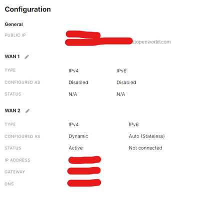

Does the MX definitely have the public IP address on its WAN port?

in the appliance status page I can see WAN2 has the ip next to it with a green active sign.
If i go to uplink config the public ip is there again with a different DNS name than the VPN one.
Just to see if there was anything on my company laptop that cold be interfering, I grabbed a spare laptop, formatted it - connected to a guest wifi and tried again with nothing installed on the laptop except the VPN client. - I get the exact same message as my company laptop - connection attempt timed out.
If you have WAN 1 configured and it is configured as primary, the VPN client will not work on WAN2, either you use the WAN IP to connect or you change WAN2 to the primary traffic shaping configuration.

both WANs are configured as dynamic. WAN 1 is enabled but not connected.
I disabled WAN1 and tried again - same error message.
Dynamic? So you don't have a public IP, right? You're behind a NAT, so it won't work.
Please provide more details of this connection if the understanding is wrong.

the MX is plugged directly into a BT router
Yes, but is the IP that is shown as highlighted public or private?

that one is private on the internal lan
Bingo, then it won't work, you need a public IP configured directly on the WAN interface, an IP with NAT won't work anyway. That's what we're trying to explain to you.
