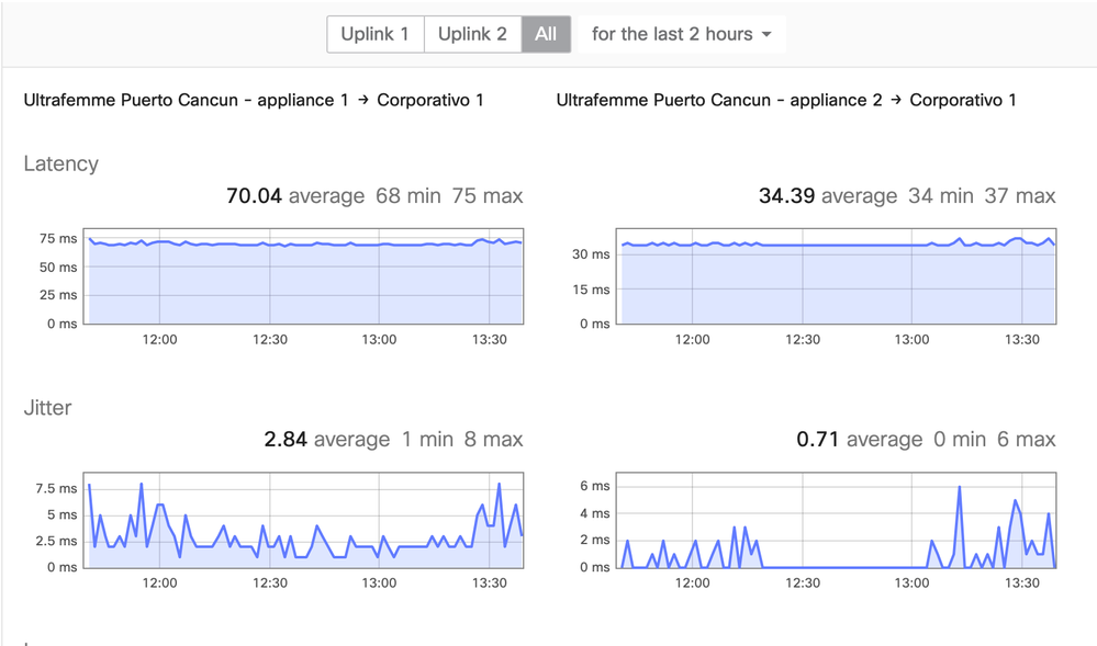

   I configured the auto-VPN for the devices, and it started to work fine, HQ has 2 tunnels to each branch, but when I see the connection between the branches, I expected to see 4 tunnels, but there is only working 2,  the Branch2 Wan1 are not establishing the VPN tunnels to Branch 1 Wan1 and Wan2:
I though it could be a problem with the Internet 1, but it is working well, and as I say before, the tunnels to the HQ are working, Wan1 and Wan2 from my branch device:

thank you for your answer! I don´t think the firewall is the cause, because as you could see, I have VPN tunnels running on the same interfaces.
