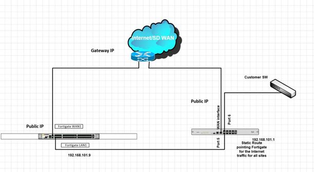

I am having Issue with the loosing connectivity to the FortiGate firewall as seen above. In my network All the branch traffic comes to this site and Internet traffic is forwarded though the static route to the FortiGate and to the  Internet through ISP gateway. what could be the issue for loosing connectivity.

Why do you have the Meraki on the internet, yet send the traffic to the Fortinet?  Why not just have the Meraki behind the Fortinet?
Merakibud
client want Fortinet behind the Meraki firewall.
cmr
So why is the Fortinet directly connected to the Internet as well, VPN?
Merakibud
Meraki as providing the site to site vpn.
cmr
So why not just have:
LAN -> Fortinet -> Meraki -> Internet
Merakibud
We needed all the branch traffic come to the Meraki and then to the Fortinet and to the internet.
we could have Meraki as VPN concentrator but since we have Meraki in routed mode we placed the fortinet behind the MEraki
