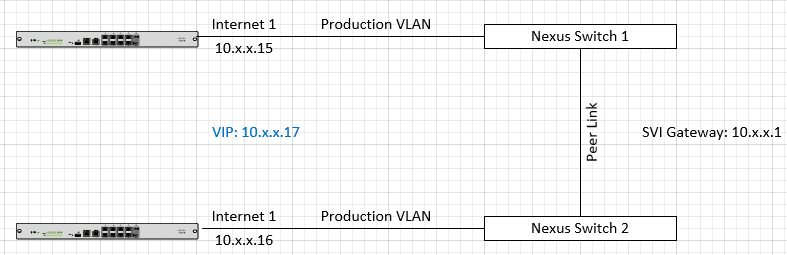

I am looking to deploy 2x MX-100s in One Armed Concentrator HA mode for VPN terminations.  I did this in one of our data centers where our core is not using VPC and was able to get it up and running rather quickly.  However, in our other data center, the entire core is Nexus VPC.  Below is a basic diagram.
My understanding is that in One Armed Concentrator mode, the Internet 1 interface is the only one used.  It is used for Ingress and Egress traffic as well as the HA heartbeat.
Nexus switches have a Peer Link between them.  That is used for control plane messages and does not forward traffic.
My concern here is that the HA heartbeat will not be seen.  The other switches connected to this VPC core are also Nexus and also in VPC mode.
The HA heartbeat from the secondary MX100 would have to traverse the switch that it is connected to, down to another switch that has a VPC port channel with both of these cores, then come back up the other nexus switch in order to see the primary HA MX 100.
I have asked Meraki Support and my Sales Team if this is even possible.  The reply is that this may not be a supported topology.
As a work around, I have thought about not deploying both MX-100s in HA, but rather as 2 separate VPN hubs.  I would not use the VIP.  On the spokes I would define both hubs.  I am sure that this would work, but it is not what I consider ideal give the time to transition between hubs if there is a failure.
Has anyone deployed One Armed Concentrators in HA mode connected to Nexus switches running VPC?

As long as there is layer 2 connectivity between the MX100 devices this will work.
However, as you mention the peer link does not forward user traffic. So how are you expecting the heartbeat to reach the other MX? From your description, I don't believe this diagram includes all devices which doesn't help.
I have never worked with VPC technology, however, I have seen this work with VSS which is similar technology.
This looks like a question better answered by Cisco TAC who work with Nexus, as opposed to the Meraki support team.

I was able to implement this and it works.  I did not need to create a separate VLAN.  We had an existing VLAN that had an SVI on the upstream VPC Nexus switches.  That VLAN also has the interfaces used by the routers that I am eBGP peering with along with the interfaces to the firewall where Internet traffic flows.
While I was not able to get a validated design from either Cisco or Meraki support, I do have it working in our environment.

Since the Meraki's are going to separate switches I'd be worried about the trunk being lost and the Meraki's going dual active.
While I cannot find my Meraki document I referenced years ago, Aaron's article still exists: https://www.willette.works/mx-warm-spare/
However, it does look like Meraki treats warm spare slightly different between NAT and concentrator modes:
"In order to receive heartbeats in a one-armed concentrator configuration, both VPN concentrator MXs should have uplinks on the same subnet within the datacenter.
For Routed mode configurations, both concentrators must be able to communicate using the LAN ports."
If you make the directly connected ports a dedicated /30 subnet you shouldn't have to worry about loops or anything. I have mine setup this way....but I also run NAT mode 🙂
In one armed concentrator mode you only have one uplink, so you can never experience a dual active issue if a VPC peer switch would fail because both up and downlinks would be gone on a single appliance.
However VPC is in itself cannot be used in this case because the MX does not support port-channels.
Individual links to both MX'es is okay though.
