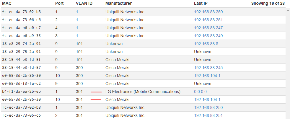

I have a client who is using a Managed Service plan from their ISP.  The ISP did not quote a firewall, so I installed a MX84.
The Managed Service provider has 3 VLANS, 300, 301, 302.  The MX84 has DHCP pools for all three VLANS.  Clients attached to a Netronix switch on VLAN 300 and 301 can get IP addresses from the MX84, but clients on VLAN 302 cannot.  The port that the Netronix switch is plugged into is configured as a trunk line and all VLANS are allowed.

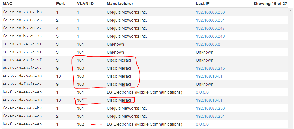

The Managed Service provider has send me images of the NAT table in the Netronix switch, and it shows the MX84 mac address for VLAN 300 and VLAN 301, but nothing listed for VLAN 302.  I cannot see the Netronix switch config, but I am told that the Netronix switch port connect to the MX84 is configured for all 3 VLANS.
Is there any reason that the MX84 would not be listening for VLAN 302?
Any help on this would be greatly appreciatedSt.Dominic_MacTable.PNGSt.Dominic-Guest_MacTable.PNG
