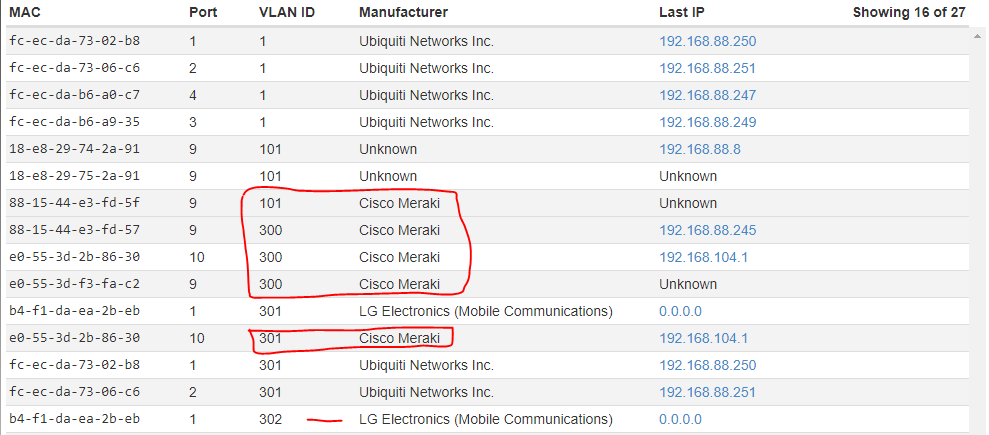

The Managed Service provider has send me images of the NAT table in the Netronix switch, and it shows the MX84 mac address for VLAN 300 and VLAN 301, but nothing listed for VLAN 302. I cannot see the Netronix switch config, but I am told that the Netronix switch port connect to the MX84 is configured for all 3 VLANS.
