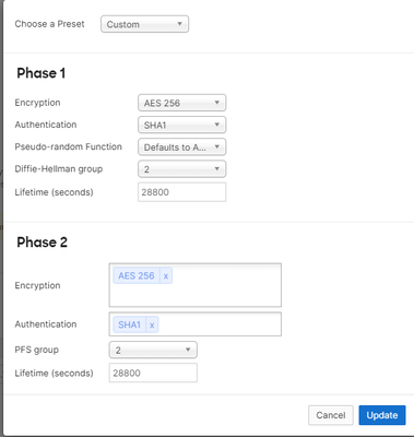

Hi Alemabrahao,
Thank you for those two links. I have already gone through these links earlier and still facing issues.
1. I don't see an option of FIPS configuration under  Network-wide -> General.
    Our Current version is : MX 16.16
2. I have configured exactly same as per above link however on Sonicwall I can see error message as:
    Message Received notify. NO_PROPOSAL_CHOSEN
3. Under Network-wide>>Event log >> All Non-Meraki / Client VPN, I can see following error:
Event type: Non-Meraki / Client VPN Negotiation
Details: msg: FIPS mode disabled
Not quite sure if this FIPS is causing an issue here.
Any suggestion will be highly appreciated.
Regards,
You don't need to enable FIPS, but you have to configure the IPsec policies password greater than 14 characters, Authentication cannot be MD5, Diffie-Hellman Group must be 14, Phase 2 encryption cannot be NULL and PFS can be configured to be either off or 14.
Set the configuration as recommended on both sides and It will work as expected.

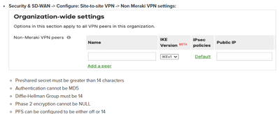

Use IKEv1 and configure it like this:
Configure the shared secret (password greater than 14 characters) with no special characters at the beginning or end.

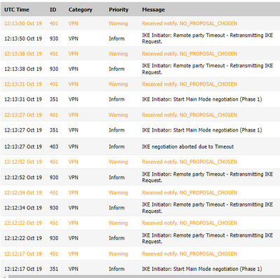

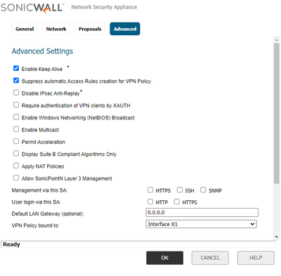

The IKE Initiator: Remote Party timeout log shows several timeout messages and IKE negotiation aborted due to timeout after a short delay, indicates that there is a communication problem or the Initiator and Responder are unable to complete the Phase 1 negotiations.
If you receive an IKE Initiator: No response--remote party timeout error,Checking the logs on the Responder SonicWall will clearly display the exact problem, ensure that the Proposals are identical on both the VPN policies.
If no log messages are available for the Initiator VPN device, then follow these steps:
Ensure that the Enable VPN option is checked under Manage | VPN | Base Settings| VPN Global Settings and the appropriate VPN policy is enabled.
Network connectivity between units.
TIP: You may try to connect via GVC software if GroupVPN is configured on the SonicWall.
IPSec Gateway address in Initiator SA specifies WAN address of IKE Responder.
If you are using FQDN in the IPSec Gateway Name or Address field, ensure that FQDN resolves to WAN address of IKE Responder.
IKE access rules enabled.
No other firewalls in the path are blocking IKE (UDP 500, 4500) or IPSec Protocol 50 and 51.
Contact ISP to see if they're blocking IKE (UDP 500, 4500) or IPSec Protocol 50 and 51.
If using SonicOS Standard with Aggressive Mode VPN, make sure the remote end’s firewall name is specified on the host firewall’s VPN policy.
If the VPN Tunnel is being established with a 3rd Party VPN device, then make sure that NAT – T is disabled (in case there is no NAT device in front of the SonicWall) .
Check the Local and Peer IKE IDs in the VPN policy if you have setup the Site to Site VPN Policy between the SonicOS Enhanced and Standard firewall.
Click Advanced tab of the VPN Policy, set VPN to bind to Zone WAN.

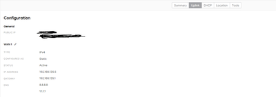

Seems you may be right as I need to find more details regarding clients connectivity which I don't have any visibility as of yet.
Also, we had another MX in different location and while checking IP config for WAN, I could see that this new site got static public IP address configured. I gave a little try to configure VPN with the same sonicwall and looks that this has either established or dropped just after VPN established:

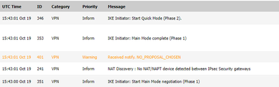

A NO_PROPOSAL_CHOSEN message being received on your Sonicwall means the MX is rejecting the attempt in Phase 1.
You'll want to open a support case, as there's no more debugging that can be done using the logs on Dashboard unfortunately

I have managed to successfully establish a site-to-site VPN with second meraki as this one had public IP address statically assigned to its WAN interface.
Its IKEv2 with following config and works fine
Issue with first Meraki is we have private IP assigned to its WAN interface . This means there's extra device ( firewall/router ) between Meraki and PE as Alemabrahao confirmed earlier.

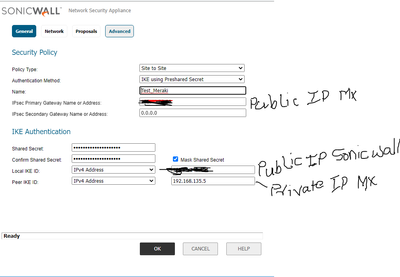

Private IPs do work, you just need to specify an Identity on each side, depending on your deployment. The issue is that the SonicWall probably isn't configured expect the MX to send its private IP as its identity, or, if it's ignoring that for whatever reason, it's sending the public IP as the ID it's expecting us to use, which the MX is not expecting, and rejecting the connection.
If you had planned on deploying the MX with a static private IP, just set that as the Local ID in Dashboard, and that should make it work behind a NAT without issue I would expect (may need to make some additional changes to your SonicWall to accommodate this as well)

In this case, you have two options, depending on the nature of your setup:
  1. Configure the non-Meraki device to expect the private IP address of your primary uplink on the MX as the presented ID
  2. Configure the peering on Dashboard so that the LocalID of the MX is whatever public IP its traffic is getting NAT'd to

@alemabrahao, as per your comment, seems I will have to add peer IKE ID ( private IP address of Meraki ) on Sonicwall
Also, remote ID on Meraki ( public IP of sonicwall ).
@Alex, for point A: I believe I will have to add peer IKE ID ( Private IP address of Meraki ) ,
            for point B: can you please outline the steps of configuring the peering on Dashboard.
Sorry, first time dealing with meraki .
Thanks
fcbob
Comes here often

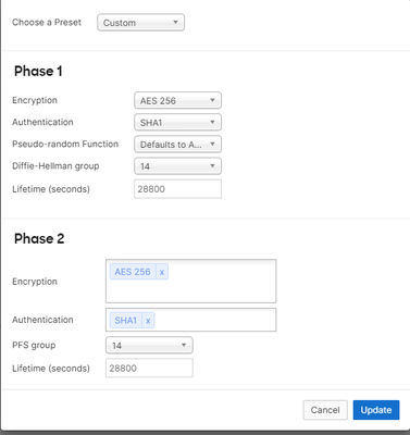

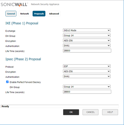

So, as per this document, I have configured on both side:
https://documentation.meraki.com/MX/Site-to-site_VPN/MX_to_Sonicwall_Site-to-Site_VPN_Setup
These are the config on Meraki Side:
Kindly let me know if I am missing anywhere any config ?
Regards
Change encryption for AES, and follow these recommendations:
  • Security & SD-WAN -> Configure: Site-to-site VPN -> Non Meraki VPN settings:
    • Preshared secret must be greater than 14 characters
    • Authentication cannot be MD5
    • Diffie-Hellman Group must be 14
    • Phase 2 encryption cannot be NULL
    • PFS can be configured to be either off or 14

Made changes to following:
Pre-shared key is greater than 14
Still no joy
As per Alex comment :
  1. Configure the peering on Dashboard so that the LocalID of the MX is whatever public IP its traffic is getting NAT'd to
    Any chance of explaining how to achieve this ?

Make sure you are allowing all traffic from your sonicwall IP address in the upstream device that is NAting to your MX.
I had a though time deploying a Meraki vMX in Azure, since Azure gives you a NATed public IP address.  The biggest issue I had was that nowhere in the deployment documentation it's mentioned that you must allow all traffic from the IP address of any none Meraki peer you want to establish a VPN connection to in the Azure Network Security Group assigned to your vMX.

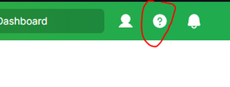

Any idea how to open a support case with Meraki ?
I have dealt with Cisco in past raising TAC case however I don't have cisco account with my current company to raise TAC case with them directly.
Do I need to have an account or can I raise on behalf of customer ( again customer doesn't have cisco account ) ?
Regards,
Go on Meraki dashboard, go to help and cases.
