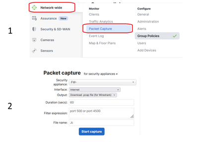

pmhaske
Hello @MyronW,
Packet captures can be taken from the dashboard by going to Network-wide > Monitor > Packet capture page. You'd need to capture it on the WAN interface—more details are below.
https://documentation.meraki.com/General_Administration/Cross-Platform_Content/Packet_Capture_Overvi...
GIdenJoe
Here you go:
Once you start capture, have the other user try to connect to the VPN.
If you wait too long the capture will stop too soon so you'll have to be on the phone to do this correctly.
