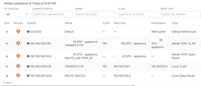

HUB:
Routing Table HUB:

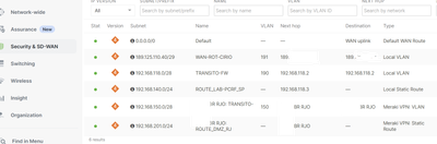

SPOKE:
SPOKE:

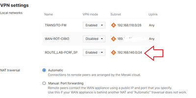

Static route
No IPsec
No dynamic protocol
I can ping both Meraki, but from FTD I can't, for example, ping LAN 192.168.140.1 from site B, which is the network of site A.

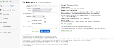

I configured the routing and rules on both FTD and ASA, and I saw that for some reason the ping did not return on Meraki (I think it was a rule). We tested it with tcp 445 and it returned, but I cannot make a machine on site A ping a machine on site B.
I am still stuck on this problem.
