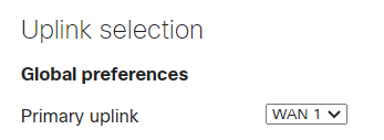

Client VPN only works on one WAN interface at a time.  It uses whatever is configured as the "Primary Uplink" under "Security & SD-WAN/SD-WAN & Traffic Shapping".
