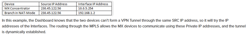

I have done lots of reading on this but haven't found a concrete answer. The Meraki doc only says the private IP will be used if both ends use the same public IP.
