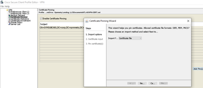

If I could quickly confirm with you. The CERTIFICATE(.PEM File) I have uploaded into the Meraki Dashboard here.
Since this is the first time updating our XML profile could you confirm the setting.
Open XML Profile editor...
Gone to Certificate Pinning
Imported my certificate here
Is that correct?
Looks like "Pinning" the Cert to the XML file does not work. Received this error message while testing.
