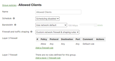

Created a Group Policy "Allowed Clients" and selected "Custom network firewall & shaping rules".  The Layer 3 firewall is Allow Any Any.  Everything else in the Group Policy is default settings.
In the Firewall -> Outbound rules, I'm denying everything.

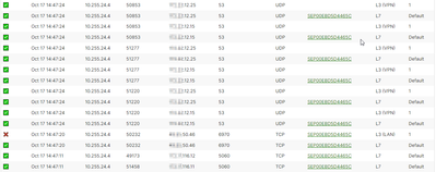

I connected a Cisco phone today for the first time and it comes into the Clients as "Normal".  My understanding is that this device will be blocked per the L3 Deny firewall rule.  However, this device is connecting fine over the Site-to-Site VPN tunnel back to Call Manager and is functional.

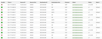

Firewall Log shows that this phone is allowed to communicate over L7 policy and also L3(VPN) policy.  L3(LAN) policy is blocked.  Maybe the L3 VPN policy is what is allowing?  Looks like L7 policy may also be allowing?

That should work.  The MX uses a flow-based system, so sometimes, when you put in a "deny any" rule, you might have to wait 10 minutes (as it applies to new flows, not flows already happening).
I can see from your screenshot that some traffic was blocked from 10.255.24.4.  It might be that you just need to wait a tiny bit longer.

Looks like there's an outbound VPN firewall as well.  From what I can tell, this firewall was allowing the VPN traffic.  My guess is that 802.1x may be the only way to really lock down access on the MX.
