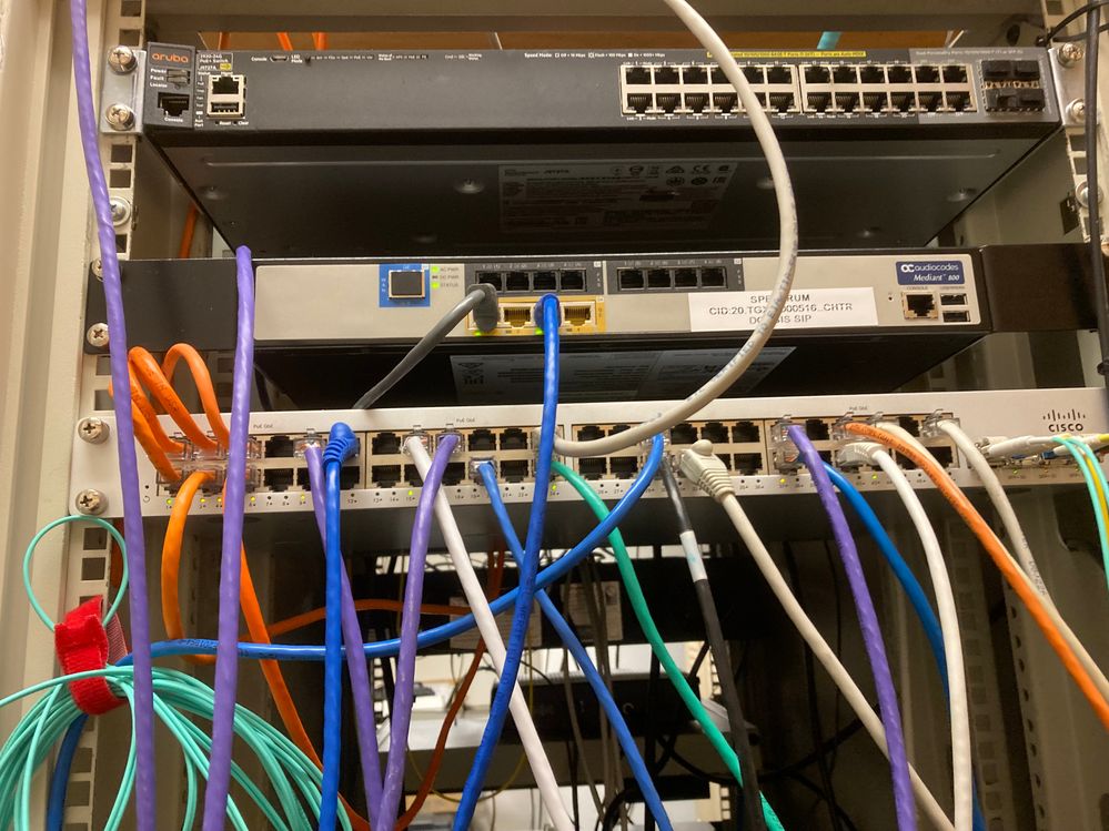

Here is our main MX and first 48-port switch. I noticed that the Elementary School and High School are only getting one strand of fiber. MXMX48-port switch48-port switch

It's okay. Any problems you can see based on the photos? Should I look into adding another fiber strand to the Elementary School and High School? And is it still worth seeing if I can upgrade the fiber cables going to the MS250s in other locations? Thank you.
Sorry, but I still can't understand exactly what you're wanting to know.
Taking into account only the images I cannot express any opinions about your network, first because I know absolutely nothing about your network, second because your question is very subjective.

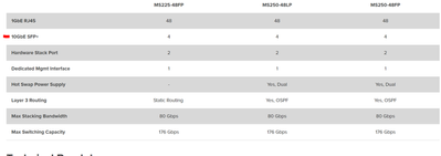

Our ISP just upgraded us from 1Gbps to 10Gbps, and I was wanting to make sure our other schools were getting the full 10Gbps if possible. The switches we're using are MS225s. I don't know if those support aggregation.
Yes, the MS supports link aggregation. It has 4 SFP+ ports
You can easily check it on the datesheet.
https://documentation.meraki.com/MS/MS_Overview_and_Specifications/MS250_Overview_and_Specifications
