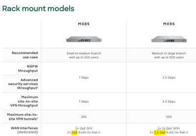

When figuring out what size of jump to, think about how much growth you might have.  For example, if you plan to keep a device for 5 years, and you think your company might double in size during that time - buy a device with double the capacity of now so you can grow into it.
The other thing to think about is the MX85 has 1Gbe Internet ports, while the MX95 has 2.5Gbe Internet ports.  During the lifetime of your new device is there any chance you might upgrade to an Internet connection faster than Gigabit?  If so, you would be throwing the MX85 away.

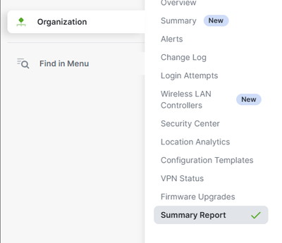

Check out the Organization > Summary report for your particular appliance Network - and the Device utilization graph within.   If you expand the timeframe from the default (a week, I think) you can get a picture of usage up to maybe 3 months.  Have a read of this:   https://documentation.meraki.com/MX/Monitoring_and_Reporting/Device_Utilization

Thank you all for the great responses. Meraki support determined I'm averaging 200 clients per day, which matches closely with the very cool Summary Report mentioned by GreenMan. The MX85 would suffice, unless our office grows in size as called out by PhilipDAth.
