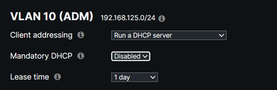

You should check your DHCP page of the MX.  Per VLAN there is a mandatory DHCP setting  that if enabled will block any static IP client.
Good point.
