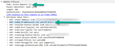

We are running MX18.107.6 on maybe 1000-1200 MX. I just noticed that the MX is sending the RADIUS packets with a NAS-IP of 127.0.0.1.  I don't remember if that is expected...
Anyone not running MX18 and could check real quick for me ?
I was expecting the MX to fill the NAS-IP with the same IP that it uses to source the RADIUS packets ( the highest vlan )

Oops ! That screenshot is from wired 802.1X in hybrid-mode ( not that It should matter 802.1x vs hybrid )

This has been brought to the attention of our Development Team before and they have informed us that this is expected in newer firmwares to comply with RFC standards. RFC 2865 states "that NAS-IP-Address MUST NOT be used to select the shared secret used to authenticate the request. The source IP address of the Access-Request packet MUST be used to select the shared secret." essentially saying that the NAS-IP shouldn't be used for authentication decisions. The source IP of the access request packet must be used. The RADIUS server must be configured to filter and process the RADIUS access request packets based on the source IP of the packet (the IP of the the highest VLAN ID), not the NAS-IP.

It is expected.  MX sourced Ethernet requests come with NAS IP 127.0.0.1 and Wireless requests come with NAS IP 0.0.0.0.  To work around this issue we define a high vlan number for management and define our network devices in ISE with this IP address.
