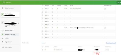

When I initially introduced the Meraki MX, we had 1 MX100 hub, which has a number of static routes and local networks terminated to it.
The device is connected to our Coe switch and has access to our primary DC and things like that. All traffic flows out via an internal Sophos firewall and then onto a managed firewall for external traffic.

Existing Original Hub with static Routes to allow outside connectivity via internal Firewall

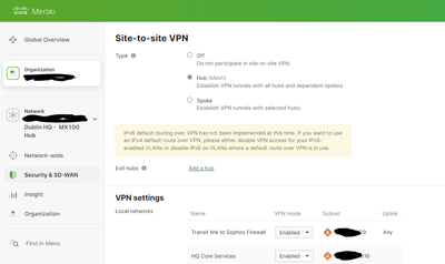

MX 100 local networks

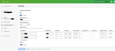

These are the vMX hubs and their BGP settings.

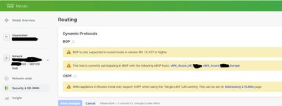

The goal is to remove the MX100 so there is no visibility of it. At the moment its using iBGP to communicate with the vMX hubs. There is this option to change the mode on the MX100 from routed to passthrough or vpn concentrator

All sites are using the Hubs ,but when you check the VPN status of the branch the MX100 is still showing up - probably because of iBGP.

If the spokes are not configured to use the MX100 as a hub, they won't (continue to) form a tunnel to that Hub - it will take some time for the Dashboard UI to reflect that though.
