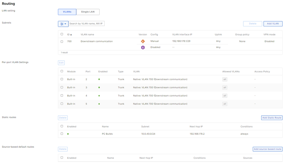

Under Routing I've configured the following:

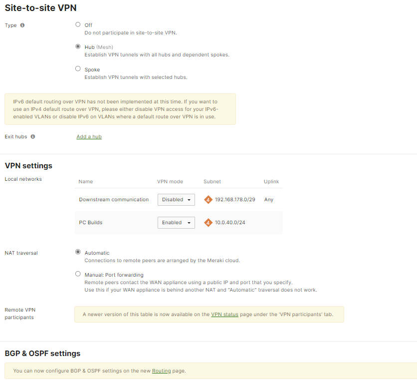

Under Site to Site VPN:
I've set up one of my networks to point to this hub. I've found that devices on that network are not able to communicate with the 10.0.40.0/24 subnet for some reason.
I'm currently a bit confused about what the port configuration needs to be for the nexus port that im connected into and if I need to do anything with the 192.168.178.0/29 vlan that I had configured. I was trying to follow guides online on how to properly set this up, but I can't seem to locate anything that gets me any further. The IP listed under "Next hop IP" was just the IP listed under this guide.
I wasn't too sure if I needed to assign that IP to the interface on the nexus that i'm connected into or what.
I'm just a total mess here and I don't have anyone in my organization who is able to guide me.
Is there anyone who would be able to provide any more insight into what I need to actually do here?

Have you created a route in your nexus switch?
And yes you need to create a transit VLAN between the MX and Nexus.
I believe you have configured an IP on VLAN 700 on the Nexus side, right?
This will be the next hop IP for the MX and for the Nexus the IP you assigned in the MX.
Also, is the Nexus port to which the MX is connected configured as Trunk as well?

add your VLAN 700 as native VLAN on both MX and Nexus.
Alejandro_F
Hi!
Additional of the recommendations from @alemabrahao. I would enable VLAN 700 in the VPN, it is need it since is a transit VLAN for your VPN tunnel connection.
