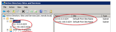

I don't know if it makes sense, but you can try this configuration.
