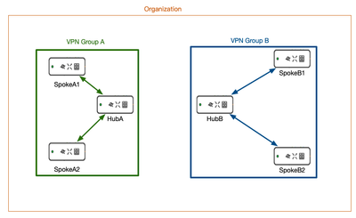

Hi Guys,
If I management MXs on same organization.
I need create site to site VPN between this MXs.
But VPN Group A and Group B did not create VPN tunnel.
The diagram like below.
In documentation is say "If the MX is configured as a Hub, it will build VPN tunnels to all other Hub MXs in the Auto VPN domain ".
Did it's possible, do not build VPN between hubs?
Thanks.

I think VPN firewall isn't bester solution on this case.
This can't solve this problem when more spoke site use same subnet.
The best way is waiting Meraki release new feature.
