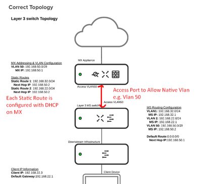

My company Network is using this Topology in the article below
https://documentation.meraki.com/Architectures_and_Best_Practices/Recommended_Topologies/MX_and_MS_B...

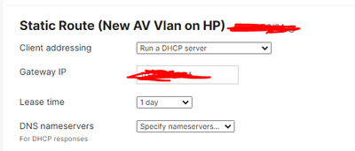

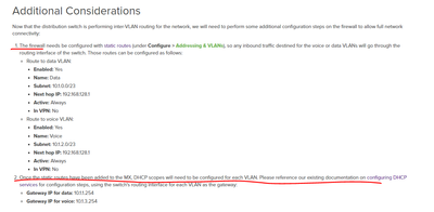

The Layer 3 Switch is using HP 3800 and all the Vlans created on it. All the Static Routes are created on MX Appliance and each Route is setup with a DHCP Server to provide DHCP services to the clients.
You can see between MX and Layer 3 Switch it is using an Access link, on Meraki Port is Access Port only Allow Native Vlan in this case is Vlan 50.
1. What I don't understand how DHCP Server give IP to downstream clients when MX is using Access Mode to connect Layer 3 Switch not using Truck Mode? should the Link to Trunk?
2. For example, a new client A in Vlan 1 want to get a IP from DHCP Servers of Static Route 1, Layer 3 Switch will forward the DHCP request to MX, but how MX decide which DHCP server to assign IP to Vlan 1?
3. I tried to create a new Vlan 3 on Layer 3 MX Switch with all the exact same setting as other Vlans, but somehow the client on the new Vlan 3 couldn't get an IP address from DHCP server, I am wondering where it is wrong.
