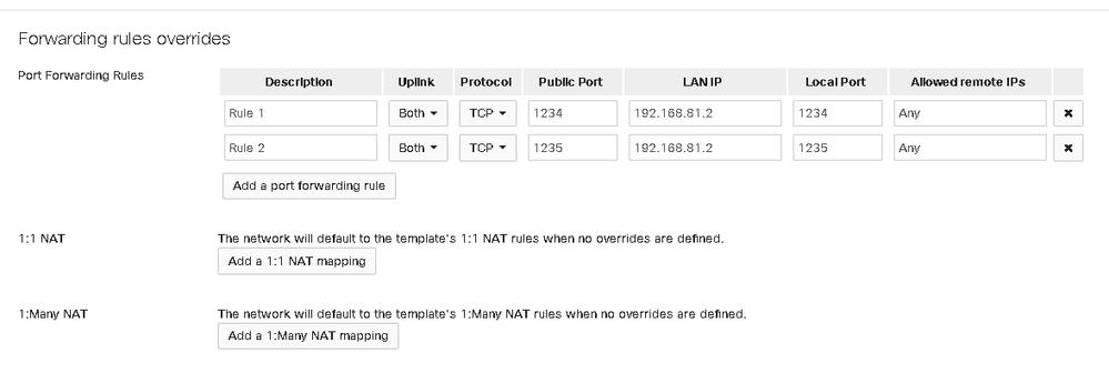

I have several networks set up using templates.  And some sites have needs for port forwarding from the public IP address.  Rules are configured in Security & SD-WAN > Firewall in the Forwarding rules overrides section.
Example:

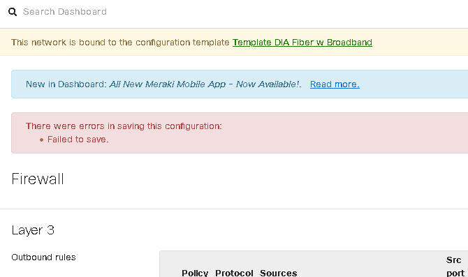

This works once when the rules are initially added.  If I try to make any changes at all, though, saving fails with a generic "Failed to Save" error.  If I want to change the description of a rule, save fails.  If I want to add a rule, save fails.  If I accidentally left the protocol at UDP and try to change it to TCP, save fails.
I opened a support case Feb 17 2020.  To get me through the immediate need, the work-around was eventually discovered that I need to delete all of the port forwarding rules and re-enter them all by hand. If I make a mistake during re-entry, I need to restart and delete everything again.
