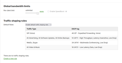

We are using the Meraki MX68 as a management network and transferring to some Cisco Nexus 9k switches last week, we were only able to upload at 320KB/s on each unit. We could do multiple units at a time but the speed limit seemed to be set per stream.  This is over Cisco Secure Client and SFTP and HTTP transfers.
I thought it might be a limit on the Nexus side but now our F5 engineer is having the same issue. This is happening at two different sites.
The MX68W are connected at 1gbps to a router with a 10gbps internet connection with nothing else in production yet. The links to the management ports on our devices are via a pair of MS-425 and MS-250 switches also uplinking at 1gbps.
Current version: MX 18.107.2
Dashboard throughput test from the MX68 showed 564mbps so it does not seem to be on the upstream router or ISP side.

200mbps is a far cry from 2560kbps (320KB/s) and it's not per VPN client, but per stream. So I had multiple 2560kbps streams going from my client to the devices.
