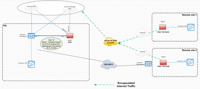

Hi everyone,
Have to merge 1 main and 2 remote sites that are on MPLS and Watchguard to Meraki + ISP internet.
But customer wants to keep the main Watchguard firewall at HQ and wants all Internet traffic from all sites go through it.
Here is what I started :
At first, only HQ (hub) and remote site 1 will be on Meraki, remote site 2 will still be on Watchguard and MPLS for sometime.
So, fulltunneling Internet traffic from remote site 1, and then telling MX84 at HQ to send all that Internet traffic into customer's Watchguard
MX84 : static route 0.0.0.0/0 on Lan cable pointing to Watchguard
+ other static routes to reach HQ's LAN and remote site 2 that is still on MPLS and Watchguard
Would there be any issue with MX84 at HQ being connected to its Internet 1 and 2, AND also having that 0.0.0.0/0 route pointing to customer's Watchguard.
I guess this way, even the MX84 Meraki cloud communications would go through the Watchguard ; so Internet 1 and 2 would only be used for AutoVPN ?
Maybe I don't see it the right way
Passthrough between Watchguard and LAN ?
Maybe VPN concentrator one-arm like in a DC (not even touching LAN at HQ) ?
thanks,
>In Concentrator mode, no routes possible I think
In Concentrator mode, all traffic is routed to the default gateway (the Watchguard in this case).  You then have that route it to wherever it needs to go - MPLS otr watever,

Well, I don't know if It is the best option, but you can create a Source-based default route.
LAN source based default route - The next hop of a LAN source-based default route is on the LAN side of the MX security appliance. The next-hop IP is known to the security appliance on the LAN side either by a VLAN or a static route.
https://documentation.meraki.com/MX/Networks_and_Routing/Source_Based_Default_Routing
Note: the keyword default route, means that a source-based default route, will not force all traffic to a configured next hop. It will only forward traffic for destinations that are unknown in its routing table.
Note: This option cannot be configured if utilizing a single VLAN
Use Case
A simple use case is segmentation. With Source-based default routing, a default route per VLAN can be configured, (for example, Guest VLAN) with a next-hop as another MX security appliance over Meraki AutoVPN or a gateway device on the LAN.

What you need to do is run the MX at HQ in VPN concentrator mode behind the WatchGuard.  All traffic will go out through the Watchguard without you having to do anything special.
https://documentation.meraki.com/MX/Deployment_Guides/VPN_Concentrator_Deployment_Guide
And then as already mentioned by @alemabrahao , run the spokes in full tunnel mode back to that concentrator.
Jeizzen
Thanks for your comments
@PhilipDAth, I'm wondering how to make it work while remote site 2 will still be on mpls/watchguard for sometime
HQ and remote site 1, ok, they will be on AutoVPN
However, I see a need for routes in MX/Watchguard for remote site 1 to reach HQ's LAN and also reach remote site 2 over MPLS, and vice-versa.
Also, would you put it inline between LAN and Watchguard (more of a Passthrough designation ?), or in one-armed
And I'm not sure I get the configuration difference between passsthrough and vpn concentrator, since we chose the same option in Addressing and VLANs.
I don't think there's a place to chose between Passthrough or VPN concentrator
Is the difference actually based on the way we insert it / use it in the design
