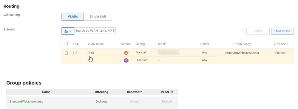

Most users will likely hit the standard content filter but in some situations more restrictive access or less restrictive access I need to have custom content filtering groups. So, I am using Group Policy in Meraki which ties back to an Active directory group. The problem is if I place a user in that active directory group they never show as a client being affected. I even have the group policy associated to the VLAN since I moved my interfaces from layer 3 at the switch up to the MX devices. But I know the user is getting associated to the correct group policy because if I move them out of the AD Group then they go back to the default content filter settings and cannot reach the webpage anymore.

When a group policy is applied to a VLAN, that policy becomes the new "network default" for any other group policies applied to clients in that VLAN. Since this policy is the new "network default," the client devices will still show a "normal" policy applied under Network-wide > Monitor > Clients.
For example, a group policy named "Guest Network" with more restrictive layer 3 firewall rules than the network-wide configuration is applied to the guest VLAN, and a second group policy "Low Bandwidth" has a custom bandwidth limit, but is set to Use network firewall & shaping rules. If the Low Bandwidth group policy is applied to a client on the guest VLAN, the client will use the layer 3 firewall rules configured on the Guest Network group policy, not the network-wide layer 3 firewall rules configured on the Security & SD-WAN > Configure > Firewall page.
https://documentation.meraki.com/General_Administration/Cross-Platform_Content/Creating_and_Applying...
The only way to see which group policy has been applied is via the Event log.

So, in order to see which group policy for sure that client is associated to within the event logs which category of logs do you see that with? I would assume if I had this policy applied at the VLAN then I would see it in some Security Appliance log?
Secondly, I guess since that is the "normal" applied policy that is why when you look directly at the group policy within Network-Wide > Group Policy that is why it shows 0?GrpPolicy_Logs.jpg

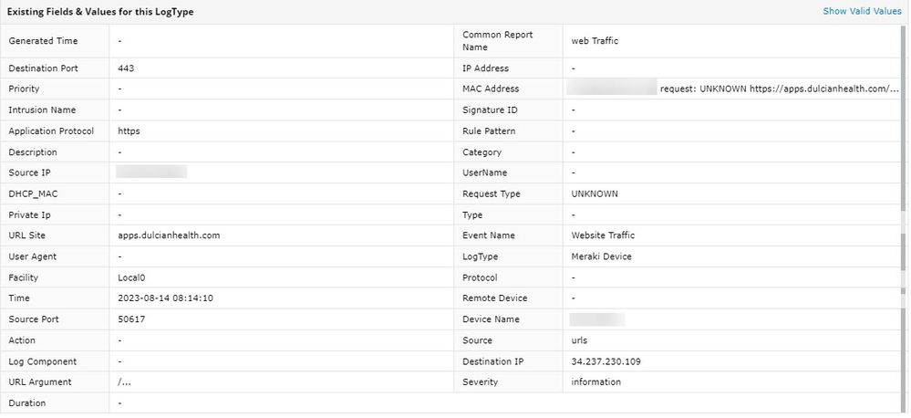

Even having an installed Syslog server doesn't even indicate the Meraki Group Policy being utilized.
I'm not talking about syslog, I'm talking about event log on the dashboard when you're using Group policy via AD.
