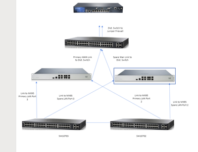

I'm going to be setting up new Meraki MX95 with HA set up. So here's ideally how the connections will be
This is based off Meraki Documentation on it

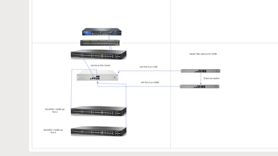

I've set up a test network to download firmware and to test the failover. Right now, we have a single meraki mx80 and i created a test network and added the two Mx95 to it and i connected them to two lan ports on the MX80 so it would connect to internet.
As well, there are two access switches that connects to ports 2/3 and so i had mx95 connections on ports 4/5. So the issue i ran into and i think i have an idea as to why i ran into it, was that the mx95 showed as dual active on both so i added a connection directly between the two Mx95 and it showed active/passive. My assumption is that even though the downstream switches were connected via ports 2/3 and the mx95 on ports 4/5, the vrrp can't go through the mx95 UNLESS the downstream switches are attached to THEIR lan ports and not the LAN ports on the mx80. Hopefully I'm correct in that assumption. Thanks for reading and possibly answer a seemingly simple question
