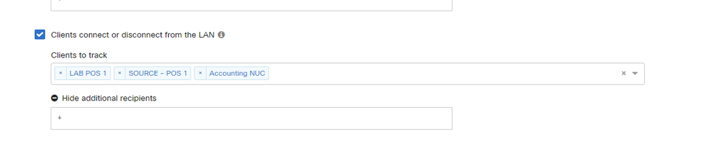

I have 25 networks bound to a template and a couple that are not. In the networks that are not bound to a temple I can configure alerts for clients to be notified if they connect or disconnect from the LAN and add the specific clients I want to track.
I don't see this alert configuration option for my template, nor do I see alerts availble to be configured at the location networks that are bound to the template. Is there some other way to set up client alerts when using a template?

@PhilipDAth when I noticed it wasn't available at the template I had the same thought, figuring that I would just add that alert at the local network. Even though the IP address of the devices I want to monitor are static and the same accross all networks I thought that it would be added at the single site. Alerts aren't even avilable on the sites bound to the template. I guess I'll make a wish and fingure something else out.
