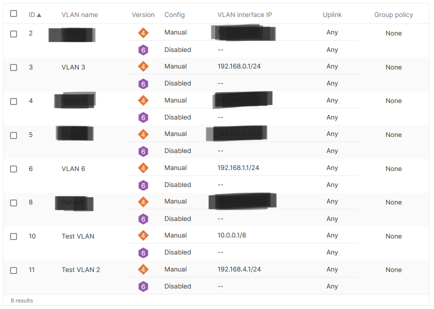

I am able to set up VLANs in the "Addressing and VLANs" settings page: (I've blurred out the ones I don't care about)Screenshot 2023-10-25 171914.png

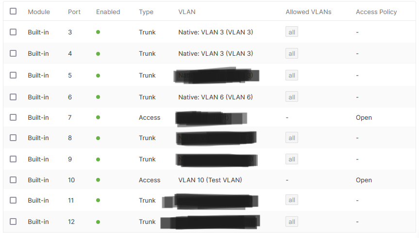

I then assign them to individual LAN ports:
I have three Managed Switches. One in Port 3, another in port 6 and another in port 10. These are all on different VLANs. I also have a server (including a DHCP server) on Port 4, in VLAN 3, same VLAN as one of the switches.
The two switches in ports 3 and 6 are completely default settings. They get a DHCP address from the server and any devices connected to them also work fine. They can communicate with each other as I have set up firewall rules to allow this.
The switch on Port 10 only seems to allow access if I configure the port in Access mode, not Trunk mode like the others. I have set a static IP on this switch (in the VLAN range - 10.0.0.2), but other than that everything else is standard. This all works.

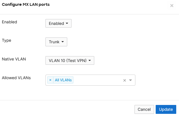

The issue arrises when I try to configure the third switch (on Port/VLAN 10) to use VLAN tagging. I want to be able to use VLAN 10 and VLAN 11 on this switch. I followed this guide:
https://kb.netgear.com/11673/How-do-I-setup-a-VLAN-trunk-link-between-two-NETGEAR-switches?language=... and everything looks fine but I completely loose connection to the network.
I think this might be related to having to change Port 10 from Access to Trunk. But I do set it with the correct VLAN settings:
I am unable to access or ping any other device on the network, even the Meraki.

Settings Access VLAN 10 is no different from setting Trunk native VLAN 10.
They are (more or less) functionally the same configuration from a VLAN tagging perspective.
The main difference in the configuration when setting it as a trunk is that you're introducing the possibility of a loop.
It may be that when configuring a trunk, STP starts blocking the port connecting to the MX, thereby dropping Meraki dashboard connectivity for switch 3.
This was my thought as well. It works fine as Access VLAN 10, but as soon as I change the port to Trunk native VLAN 10, everything just stops working. I think this is something I need to figure out before configuring the switch ports on different VLANs.
It probably would be simpler to config the same native VLAN everywhere and config the ports on the downstream switches as @PhilipDAth suggests, but it's my understanding that as long as the Allowed VLANs is set to 'all' it shouldn't matter too much? I have tried changing the native VLAN on the trunks, but it made no difference.
