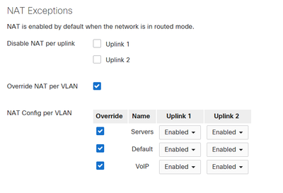

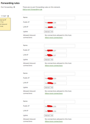

Here is a little secret.  You can create a VLAN on your MX using the /28 of public IP address space, and create a 1:1 NAT for each public IP address, where the public and LAN IP address are both the same public IP address.
You can also use the NO-NAT feature for an VLAN to use it for pure routing.  You enable this under Early Access features (under Organization).

Thank you for the "little secret". I've decided to try using an EdgeRouter and see if I can get it figured out. Great to know there is another option in case I can't figure it out.
Many thanks for your help.
