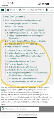

There was another section for warm spare swap method and this was for cold spare in the sense you cannot have both active but want to be prepared and have the spare one which could be a different model be ready so it's only a matter of swapping cables in the event the main mx died on you. I have pasted the table of contents to explain my point just if you have time and want to see thru my lens and the build up frustration pondering and testing it over it for so long on a weekend.
