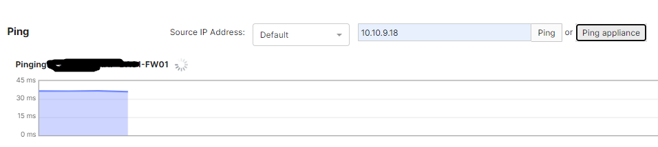

My Meraki can ping the Radius-server from default source.
