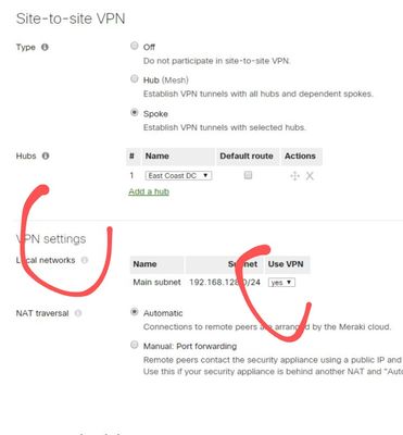

Are all networks enabled to participate in SD-WAN?

I am not using site to site VPN just Client VPN. The server is behind the MX68 and is getting an IP from the MX
But you need to enable each subnet behind the MX including the VPN client to receive the routes, even if you don't use SD-WAN, otherwise how do you expect to have the route for your internal network?
Enable this and it will work.

Interesting, where would I go to enable this? I believe (could be wrong) that this is on by default as I can ping the users who connect via Client VPN from the server network and vice versa, they can ping the server and the printers and the server can ping them, but broadcast and mDNS do not pass from Client VPN VLAN and local VLAN.

I am not able to turn on site to site VPN, as I have no other site to connect it to, just a single location with a single MX68 appliance. The users connecting are using home internet and the built in Mac vpn client and I have enabled Client VPN on the MX68.
Yes, you are, I have a MX at home and I'm able to use it.
You just need to configure it as a Hub. It's pretty easy.
dlevens
Screen Shot 2024-03-17 at 6.05.22 PM.pngYou were right, I was able to turn it on using Hub but would get the attached error if I tried with Spoke. However even with Hub on and both my Client VPN and local LAN enabled for use VPN I could still only ping the client and could not view mDNS or any broadcast and could not resolve nslookup.
