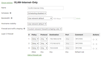

I often use a group policy when I have VLANs that only need Internet access.  Under Network-Wide/Group Policies I would create something like:

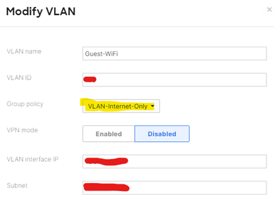

The on the Security & SD-WAN/Addressing & VLANs page, apply that group policy to the VLAN.
