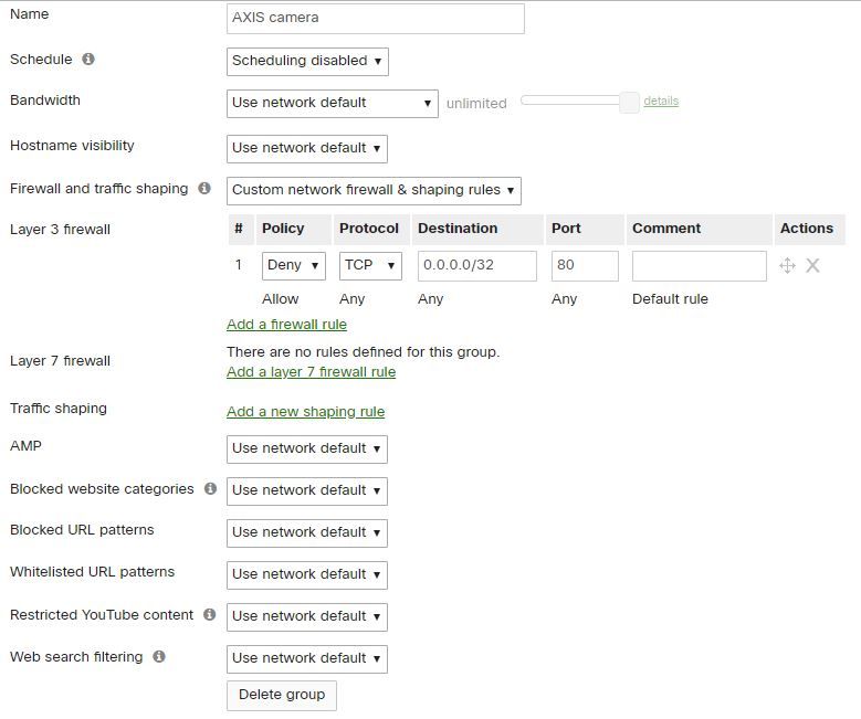

One of our cameras is accessing the internet, and looks like it's slowing us down.  I created a group policy and applied it to that camera.  Is this correct?  I only want this group policy to block all internet, and only allow LAN traffic.
BrechtSchamp
It will not only block internet access, it will block all access to other subnets. Unless you have a flat network with only one subnet you would need to add exceptions for your local subnets to be able to communicate with each other.
The rules below would cover all private ranges (but is likely overkill for you):

Hi, it would be overkill to use group policies to only block internet traffic for a single host (camera)
you would be better off just using the standard firewall.
it would be wise to investigate why the camera initiates connections to the internet. Most probably to check into some vendor service.
You could also look at restricting the bandwidth for said device using the very group policy you have already created in the traffic shaping section.
hope this helps
BrechtSchamp
Whether you do it in the regular firewall or in the group policies, 0.0.0.0/0 would be the catch-all, not /32. I'd also set the protocol as well as the port to any. Unless you know that the camera's traffic is specifically using TCP and destined for port 80.
Also keep in mind that this would effectively limit the camera to only being able to communicate with devices in its own subnet. Other subnets in your own network would also be blocked. So it would make sense to add your local IP ranges as exceptions.

So for the layer 3 firewall I have
Deny Any Any Any
Allow Any Any Any
This should work right?  It will block internet, but will permit all other networks.
BrechtSchamp
