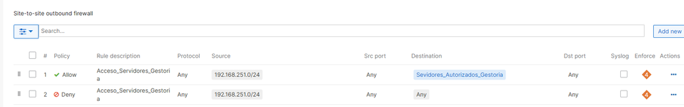

athan1234
A model citizen
Thanks for the suggestion and the documentation link!
After reviewing the Site-to-Site VPN Firewall Rule documentation, I understand that these rules are organization-wide and apply to all MX networks participating in site-to-site VPN.
To confirm my understanding of your approach:
I would configure the rules under Security & SD-WAN > Configure > Site-to-site VPN > Organization-wide settings:
  1. Allow rule:
    • Source: VPN client subnet (e.g., 192.168.100.0/24)
    • Destination: Specific hub servers (e.g., 10.0.1.50, 10.0.1.51, 10.0.1.52)
    • Action: Allow
  2. Deny rule (below the allow rule):
    • Source: VPN client subnet (192.168.100.0/24)
    • Destination: Any
    • Action: Deny
My question: Since these are organization-wide rules, will this configuration affect VPN clients from other spokes that might use different subnets? Or as long as I specify the exact VPN client subnet from this particular spoke, other spoke traffic won't be impacted?
Is this the correct implementation of your suggestion? Want to make sure I understand the scope and impact before implementing.
Thanks for pointing me in the right direction!
jimmyt234
Head in the Cloud
Your understanding is exactly what I was thinking.
As you say - client VPNs on other spokes will be different source subnets so not subject to your policies. As with anything, make sure you test after implementation to ensure it is working as desired.

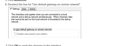

Hello, I'm experiencing some strange behavior and I’m not sure if it’s normal.
Here’s my setup:
  • On the spoke, I created outbound rules.
  • I unchecked the split tunneling option on the network adapter.
When I test the connection:
  • I get Internet access, but I cannot reach the server when the adapter is configured with split tunneling.
  • I cannot ping the servers or the MX hub gateway.
The server VLAN in the hub is enabled, and I can see the route in the spoke’s routing table.
On the other hand, when
I configure the adapter as full tunnel,
I can reach the hub VLAN server and the tracert completes to the Meraki hub gateway — but then I lose Internet access (maybe because I set the DNS server to the customer’s DNS).
Is this behavior normal?
jimmyt234
Head in the Cloud
I believe you've created those firewall policies under the Layer 3 section rather than the site-to-site VPN section.
athan1234
A model citizen
Sorry, yes you are right. I created the rules in the Site-to-Site outbound firewall
Same reoult like this :
