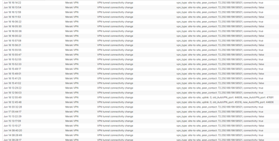

Looking at one of them, the logs are filled with the autoVPN constantly dropping and reestablishing.
