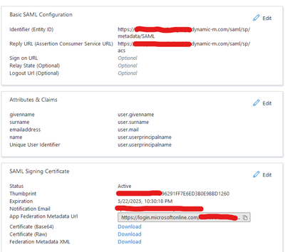

Set up AnyConnect Azure AD SAML. One user authenticates successfully and receives 'Can't reach this page' in the Cisco AnyConnect Login box after providing MFA.

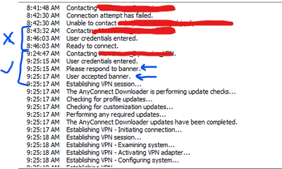

When I test with my admin account, this first time it hangs after successful MFA and finally gives a 'CSRF token failed' message. Then each time I attempt afterward it will successfully connect. Here is the AnyConnect log showing the first failed attempt and the subsequent successful attempt:

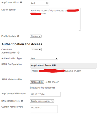

I notice the first time, I don't see the banner message. Both users testing (including myself) are in the Azure AD enterprise app group.
My AnyConnect / Azure AD settings:
