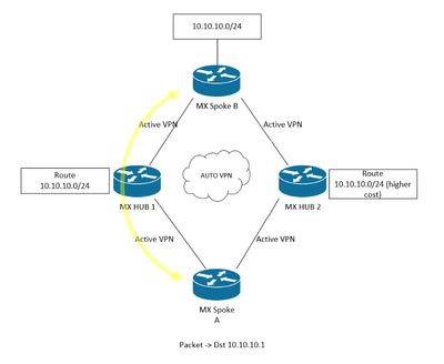

We have Auto VPN with only one hub enabled and multiple spokes. Am I right in thinking that adding a second hub will, by default, become a failover for that hub without any extra config?
Please see diagram as to how I think it works. I assume that hub 2 install routes to all spokes but with a lesser route priority/higher cost?
Primary aim is to provide resilience to Hub 1 site.

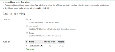

No - you would need to configure your spokes with the extra Hub.   The order in which you specify the Hubs (which one's nearer the top of the list) will determine, for each Spoke, which path is taken.    Note that, by default, you wouldn't need to configure, to advertise the route via the Hubs - spoke-to-spoke routing is enabled by default.
https://documentation.meraki.com/MX/Site-to-site_VPN/Site-to-Site_VPN_Settings#Configuring_Multiple_...
As informed, you need to add the second HUB in the Site to Site VPN settings.

OK That makes sense, add second hub to all spokes... and this defines the failover topology... thanks all
