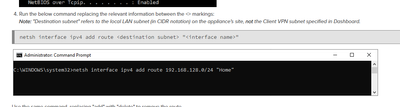

https://documentation.meraki.com/MX/Client_VPN/Configuring_Split_Tunnel_Client_VPN
will try that out thanks!

Still, proceeded to try to re-add the route as:
netsh interface ipv4 add route 10.10.10.0/24 "client VPN"
with this result: “The object already exists”

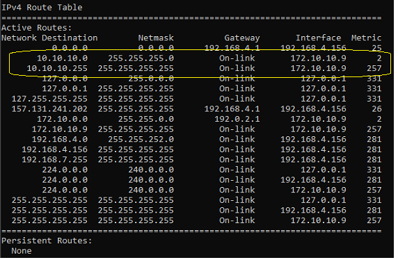

fwiw, here's a screenshot of the IPv4 route table of the problem system.
endpoint IPv4 address over VPN adapter: 172.10.10.9
remote LAN network IP: 10.10.10.0/24
Further, we compared the route of problem system with a known good working system - route table  of the 10.10.10.0/24 entries were identical.
