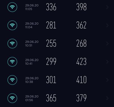

I realize that max speed capabilities will only go as high as any 2x2 wifi device(meraki GR10) will push out, and in this case sounds like it's somewhere around 300Mbps.
Wish there was a 3x3 or 4x4 access point.

The point of this question is to mainly understand the max throughput of the access point because I could not find any documentation providing this information. I don't want to purchase and then find out the max output is 250Mbps.
QUESTION:
Based off your description, if my ISP speed is 1 Gigabit up and down, and for WIFI IF ALL CONDITIONS ARE PERFECT(placement, no walls, etc..) that means the access point is capable of providing Wifi speeds close to 500Mbps up and down?
