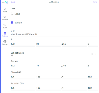

This GX20 sits behind a modem/router set as passthrough, so all incoming traffic is directly send to the GX20. It uses a Class B type address to connect to the modem/router. No firewall rules apply to that type of connection.
