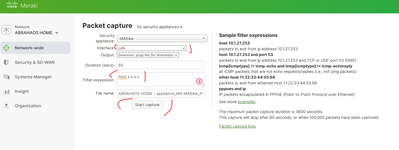

Yes, but you can perform a packet capture on Meraki dashboard. Do you know how to do this?

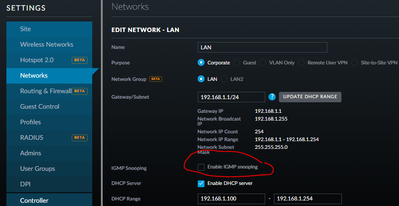

Are you able to enable an IGMP querier (or similar) in the CCTV VLAN on the Ubiquiti switch?
I can try enabling IGMP for second VLAN
(never mind IP shown in pic, I just downloaded pic)
Can you provide more detail about your network? Like a topology or something like that. I'm confused now, because I noticed that the IP ranges is not the same that you described when you started the topic.
Topology consists of one Unifi 16port switch, Meraki MX appliance, with 2 setup VLANs. I tried with enabling IGMP snooping on 10.0.0.0/24 network, same result. Picture I posted for IGMP was just downloaded from internet, so just to clarify, 2 VLANs are 172.16.20.0/24 and 10.0.0.0/24. CCTV server resides on second VLAN (I am really sorry if I made confusion for you guys with that picture - also I noticed I mistyped in first post network details regarding first VLAN - it is 172.16.20.0/24). Devices from first VLAN can ping devices on second VLAN, and can access web service for CCTV server at 10.0.0.9:8081 without problems. It is just the app that uses 22609 port and it is not working.
