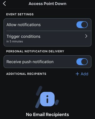

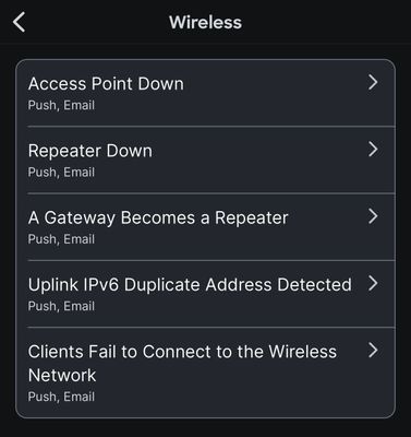

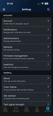

I don't recall doing anything special. Checking my app settings > notifications > wireless it looks like this. Does yours look different?

Indeed, the look is different on my phone.  (I'm using iOS if that makes a difference.)

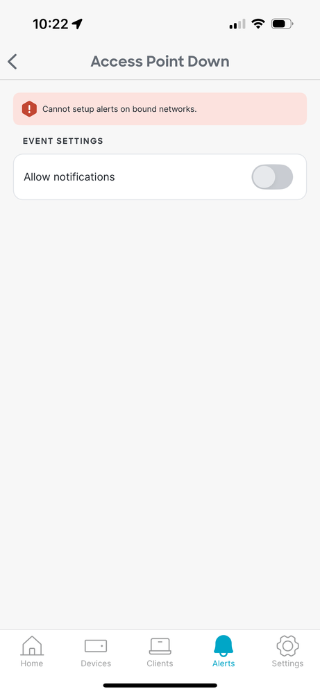

There is no "Notifications" option in Settings, but there is an Alerts tab at the bottom, and in that tab there is a gear icon in the upper right to configure alerts.  Any option I select looks like this:

Ok, so I poked around the app some more. If you're in a non template bound network the settings > notifications section is visible. If you're in a template bound network it's not shown and looks like your screenshot. I too am on iOS 26 running the current mobile app version.
So, if you go to a non template bound network do you see notifications? And if so enable it and them test downing a template bound device if possible.
When in a non template bound network.
When in a template bound network.

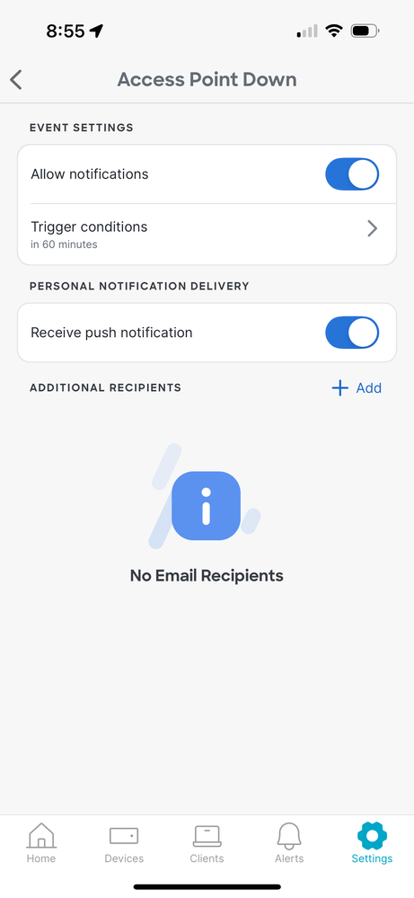

I created a network that is not bound to a template.  I then opened the app and selected that network and was able to enable alerts via Settings / Notifications...
I then disconnected an AP in a bound network.  Unfortunately, nothing changed... I did not receive a notification on my phone from the app.

Did you leave the device offline for >1 hr given your trigger config in the screenshot?
EMU_IT
Thanks for highlighting that, which I missed in my testing.  I changed it to 5 minutes and tried it again today, but it didn't make a difference... still no notification when an AP in a bound network goes off-line.
