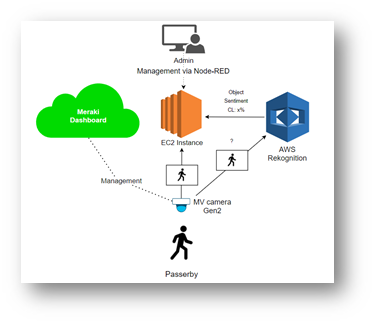

To achieve this, I deployed a 3-tier application with:
- Images to work with, ideally a constant flow of images to make use of Automation.
i.e: Meraki MV 2nd gen cameras (any model ending in “2”) — they support the MV API, required for API calls.
- A relay server to capture the images when an action is triggered and forward images
i.e: Linux server in AWS to run the Python Script orchestrating all the API calls to Meraki and AWS. This server will also be our MQTT and Node-RED server running our Admin interface.
- A Computer Vision solution that will apply AI to categorize the image.
i.e: AWS Rekognition
This is a simplified view of how these will be linked:

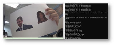

This is what I could get from the Camera feed at the end:
Pretty great!
