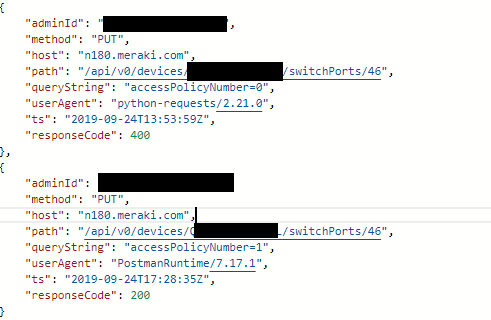

this used to work fine when I first used it a couple months ago - now I see a status of 400 in the API history when I run it.
The script works fine to grab the data, but when it goes to PUT the data, it does not update the port. No errors while running the script.
When I do a call to the API to see the last API PUT calls, it shows the postman call and the python script call as identical besides the user agent and return status.

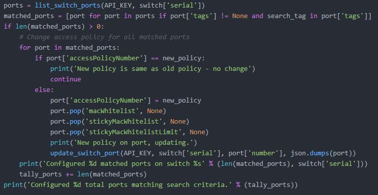

what details for the port are you defining to update on the port. I'm noticing a problem with the following parameters you should be able to remove these if not required and the script should run.
macWhitelist
stickyMacWhitelist
stickyMacWhitelistLimit

the meraki github code pulls all of the attributes of the port into a variable, then updates the access policy variable and sends it back.
I am not sure how to strip out any of the attribute before it sends the update to the switch.
