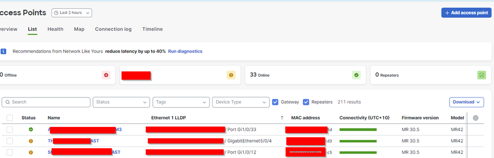

Via API, I need to find out the name of the switches that the access points are connected to.
joedelapaz
I can generate a list of access point names and serial numbers via the API.
However, I need to programmatically find out the name of the switch that the access points are connected to.
The Dashboard can generate this info via the Ethernet 1 LLDP column.
Is there a way to access that information via the API?
Any help would be greatly appreciated.

You can use the getLldpCdp endpoint. 🙂
https://developer.cisco.com/meraki/api-v1/get-device-lldp-cdp/
RaphaelL
I would use : https://developer.cisco.com/meraki/api-v1/get-organization-switch-ports-statuses-by-switch/ ( Beta ). One call to return all the info will be more efficient than getLldpCdp
