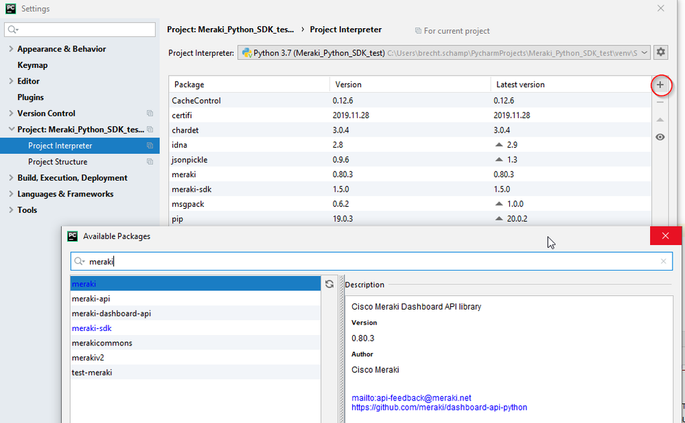

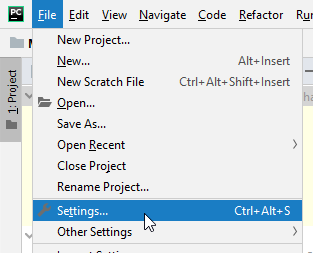

Now for the actual code. I'd recommend to setup a Python project in PyCharm or something alike. As soon as you've imported the meraki module into it, it can start giving you code hints. That'll make everything much easier for you:
To do that, in short, you need to create a project in pyCharm and the key is to go to the project properties like this:
In there you can add the meraki library to your project like this:
You may also want to try to simulate your plan via Postman first... That will allow you to test the calls and see their results before actually starting the coding:

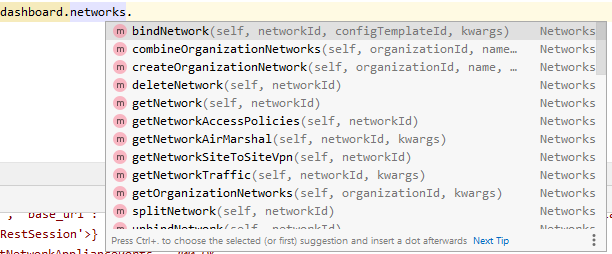

This should get you a bit further. I think you used an older method to create the dashboard object. It think that's why it wasn't showing the code hints (Dashboard() vs DashboardAPI())

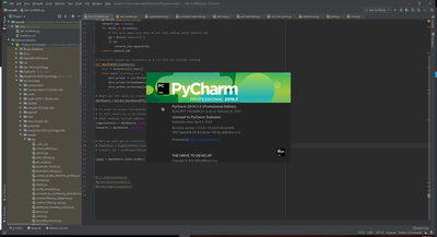

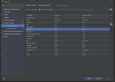

I wonder if you're using an older version of the module.
What version does it say in the project settings (where you add the meraki module)? I'm using 0.80.3.
Also, what version of Python are you using? I'm using 3.7.

I will take a look at getting python 3.7 installed and setup a new project with it and see if that helps. In the meantime, here is all the information
Python Version:
C:\WINDOWS\system32› python --version
Python 3.8.2
PyCharm Version:
Meraki Module Version:

Python 3.7.6 works???? Very interesting....... It would appear things are working correctly now. I have all the auto complete features too. Maybe this is a bug with their module? Not sure. Regardless. Thank you very much for taking the time to help me out. Once I have a completed script I will post it here so that the people that come after me can use it.

So I am fairly confident I narrowed down the issue. It would seem that if I install any of the other meraki modules it will cause errors. For example, if I start a project and only install meraki, it will work. However, if I also install merakiapi, it will error out. Maybe there is a confliction.
